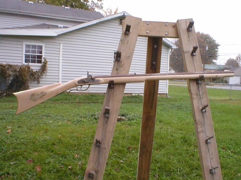

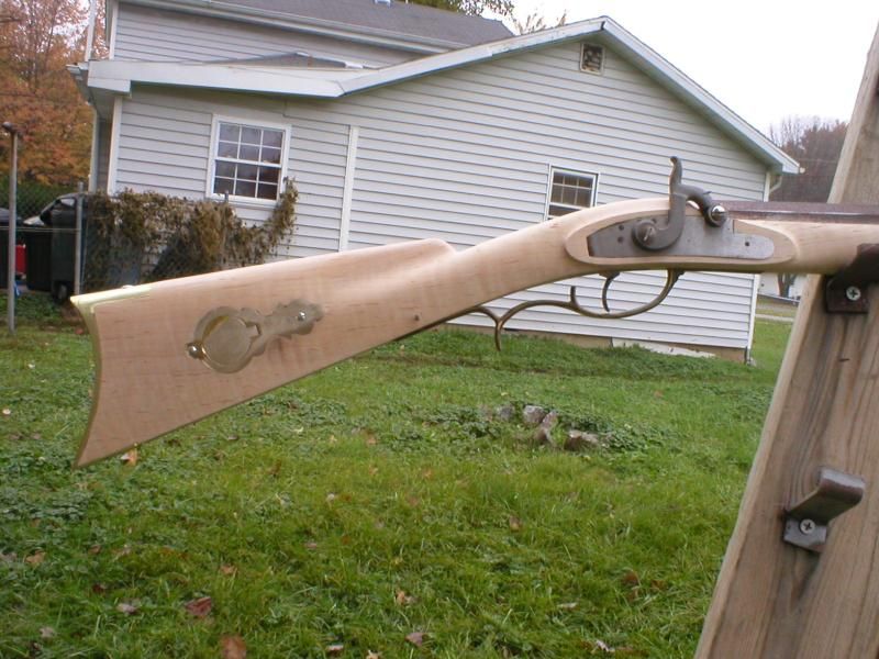

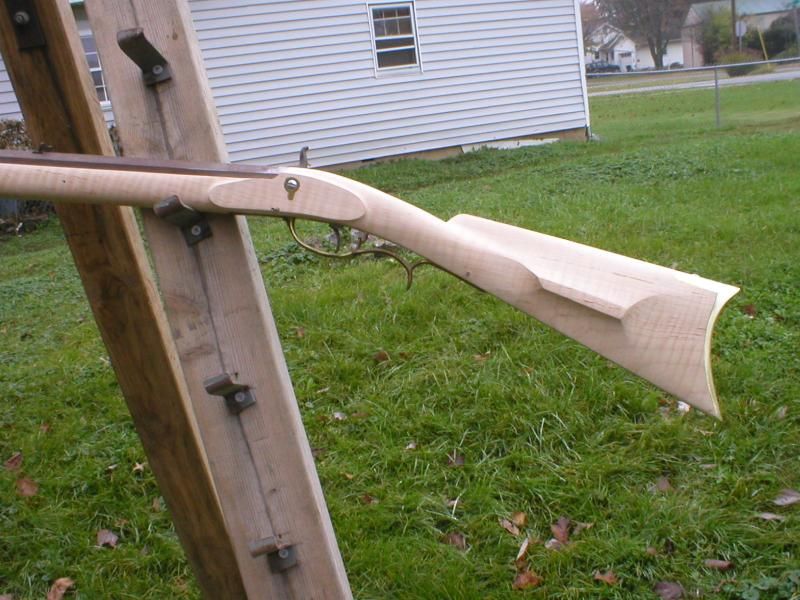

Since this is a pretty much standard item for me I won't show every last one I build from here on out -- but this one's pretty cool. Normally these guns are halfstocks, but they were made, also, as fullstocks, well into the middle of the 19th century and probably beyond (a capture of a page of a Tryon catalog from the 1870's offers a fullstocked rifle right along with two or three variations of the halfstocks), and lately that seems to be what people want me to build. This is the highest-grade model I offer, with a Colerain 30" x 1" .54 caliber barrel (barrel lengths can be had out to 36"), L&R lock modified to more resemble certain styles of trade percussion lock of the period, and a Leman-style "wilted lily" capbox modified to a pattern seen on a number of James Bown rifles, which are the models for this line of guns. The owner wanted the single trigger due to this being a Texas "hog rifle" with the "hogs" in question being big and mean and there being no time or need for foolishness like setting triggers.
P+ curly maple that will be finished with a red-brown stain and tung oil, with the steel browned. The guard did have a spur up on the trigger bow, but it was requested that I make that go away, again as was done on a number of the originals.
 thmbsup Mike i dont think any thing you build is standard.Way above standard.

Mike thats a NICE looking rifle!! Is that somthing that one can order?
