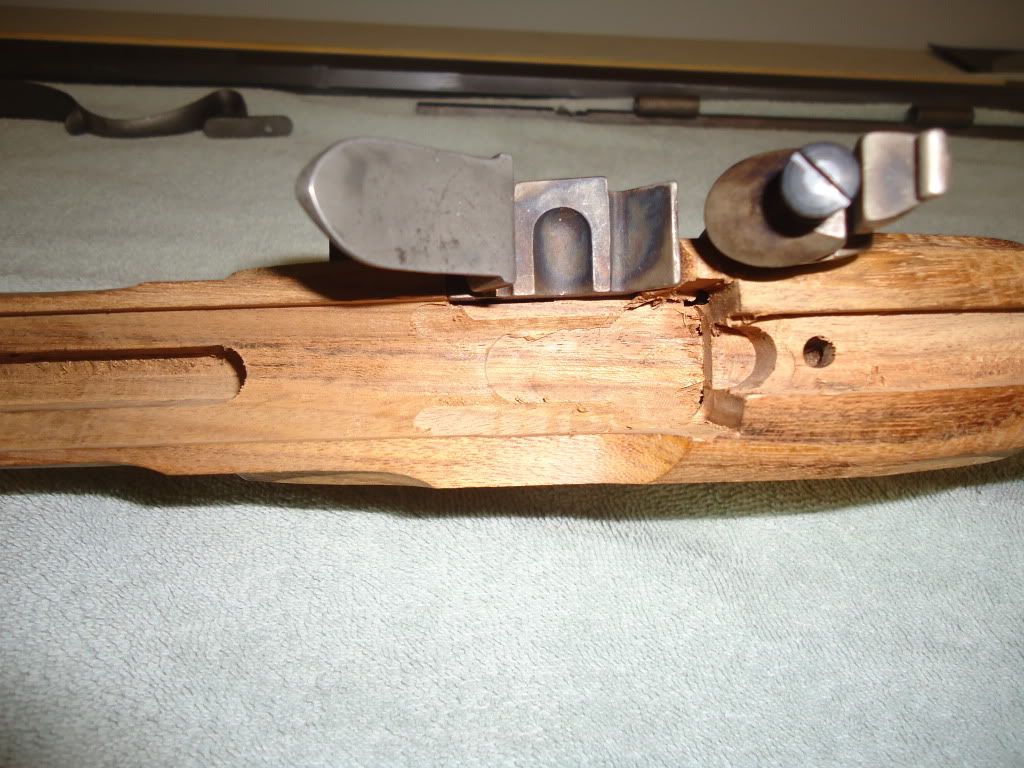

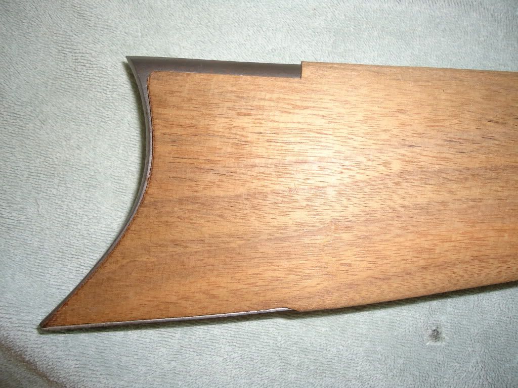

That's ridiculous, I'd contact Lyman and send that stock and tang back for a better fit, that's way out of line, their ready to purchase rifles have a much better fit than that!, One thing about factory Hawken replicas is that they leave way to much wood long the fore stock and the barrel channel, the wood should roll in to the barrel not have a 1/8" shoulder between the barrel and the finished face of the fore stock, and there is too much wood left on the wrist also!

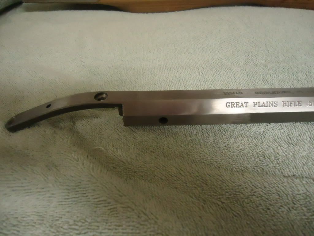

A small gap behind the breechplug tang is necessary on any gun generating any recoil to speak of, for the reason Rusty Spur mentioned -- you'll chip wood out there as recoil seats the metal a hair further back in the wood. However, I can see that the hole for your vent liner is already positioned slightly to the rear of the pan on the lock, while the screw holes in the tang are forward of the holes in the wood. If you remove wood and move the tang back so that the screw holes line up, you'll close the gap to an acceptable amount, but your vent hole will be too far back of your pan's center.
Hate to say it but IMHO that stock needs to be sent back with a precise explanation of what's wrong with it. The fix necessary to make everything fit and work as it should is more in line with what a skilled gunsmith would do, not assembly of a kit rifle.

I agree.That is rediculas.The vent should be centered with the pan.If the tang was moved back to close up the gap,it would make matters much worse.I would contact Lyman also.Although,I have been waiting for 11 weeks for some screws that were missing out of my kit.They did say that they would replace them though.I hope I am still living when they arrive.

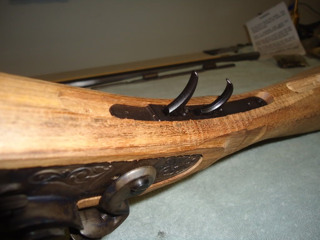

Here are a couple more pics. Notice in the last one there is very little wood between the barrel channel and the lock bolt hole. In fact there's a no wood in spots. Would this be a week spot? If so that might be the clincher that sends it back. I hate to have to wait to get started but seeing as I'm building this rifle primarily for hunting and not just plink'n I want it to be a solid peice. It will be used.

The lack of wood between the barrel channel and ramrod hole isn't a weak spot, and since there's no forward lock bolt used on the GPR it's not an issue so far as the ramrod sliding all the way back to the breech as it should (on rifles with a forward lock bolt, the bolt passes under the barrel and there needs to be at least 1/8" of wood there). It is, however, another thing that shouldn't be.
Probably the easiest fix, so you don't have to make a new vent liner with a forward-biased vent hole (which could be a pain in the butt) or try to patch in wood behind the breechplug tang, is to find someone to weld about 3/16"-1/4" of steel to the end of the tang, oversized enough that you can work it down to match the contours of the tang. Square it off or round it as you like, then extend the inlet in the wood back enough to accept the extra metal. This will keep your vent acceptably close to the center of the pan and save you having to hog back the wood at the breech. Plug and re-drill the screw holes in the stock wrist.
Or send the stock back and hope for something better when the new one arrives.
